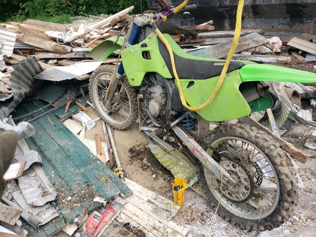

So my pops' retirement gig is running those large private dumpsters around.
Well he calls me yesterday and says hey you need to come up to the consolidation yard. That I needed to bring my truck and take my bed cover off... I like yum why??
He goes well I just pulled a dirt bike out of a dumpster. I'm thinking I don't need some Chinese pit bike project, when he goes I think it an old kawasaki 125. Come check it out and run the Vin to see if it's stolen or if some one just got tired of it being in the way in the garage.
So I got off work picked the boy up and off to meet up with papaw. Pull up and here sits a 1993 kawasaki kx 125.
Dad comes out of the excavator and says well its not seized up, but didn't feel like much compression, and I broke the handle bars getting it out of the dumpster.
I checked for a Vin, all the numbers are there, run it and it nothing comes back on it. So up in the truck it goes.

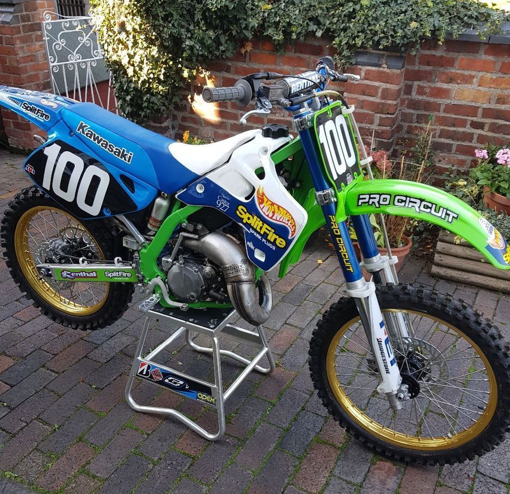

This is what I eventually plan for it too be.

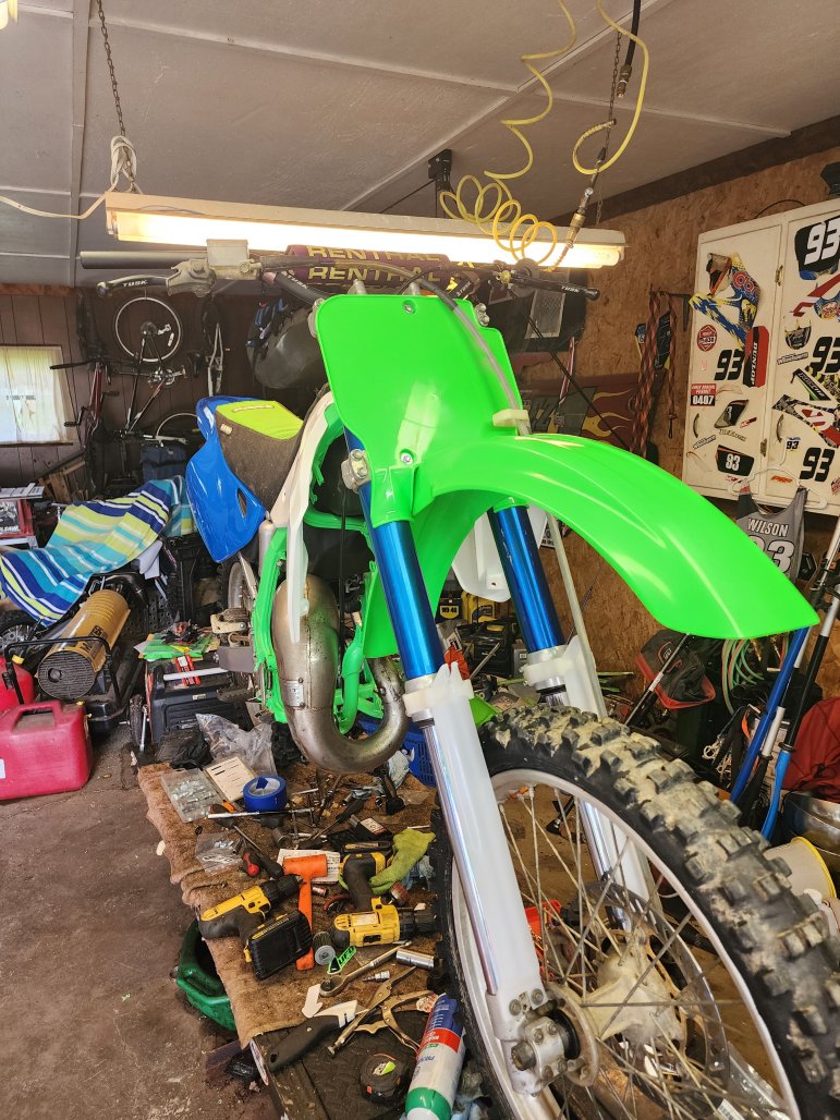

Mounted up plastics and the foot peg springs with ims pegs.
Waiting on the cylinder to get back still.
